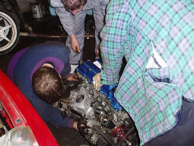

It's a real team effort, everyone is pitching in and getting involved and getting filthy too!!
It's all coming together now and really starting to look like an engine again!
More hard work going on above, sorting out the fiddly bits that need to be sorted out!
We have a plenum!! Things really taking shape now, it's feeling at this point that this is really happening and the end result can be achieved in one day but there is a fair way to go yet!
